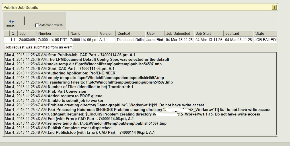

We are having issues this morning with some of the drawings NOT getting published on the cad worker. We are seeing the below error message when we look at the publish job summary. Note this is only happening to some users/drawings.
I did see the article (CS33760) on ptc.com and still confused on why some users are having problems and others are not.
We are using WC 9.0 M060 and Wildfire4
Thanks for the help.
Mar 4, 2013 11:25:46 AM:Start PublishJob: CAD Part - 74000114-06.prt, A.1
Mar 4, 2013 11:25:46 AM:The EPMDocument Default Config Spec was selected as the default
Mar 4, 2013 11:25:46 AM:make temp dir f:\ptc\Windchill\temp\pubtemp\publish54597.tmp
Mar 4, 2013 11:25:46 AM:Start: CAD Part - 74000114-06.prt, A.1
Mar 4, 2013 11:25:46 AM:Authoring Application: Pro/ENGINEER
Mar 4, 2013 11:25:46 AM:empty temp dir: f:\ptc\Windchill\temp\pubtemp\publish54597.tmp
Mar 4, 2013 11:25:46 AM:Transferring Files to: f:\ptc\Windchill\temp\pubtemp\publish54597.tmp
Mar 4, 2013 11:25:46 AM:Number of Files (identified to be) Transferred: 1
Mar 4, 2013 11:25:46 AM:ProE Part Conversion
Mar 4, 2013 11:25:46 AM:Added request to PROE queue
Mar 4, 2013 11:25:47 AM:Unable to submit job to worker
Mar 4, 2013 11:25:47 AM:Problem creating directory \\ama-graphlib\S_Worker\w1i1j15. Do not have write access
Mar 4, 2013 11:25:47 AM:Part Processing Returned: $ERROR$ Problem creating directory \\ama-graphlib\S_Worker\w1i1j15. Do not have write access
Mar 4, 2013 11:25:48 AM:CadAgent Returned: $ERROR$ Problem creating directory \\ama-graphlib\S_Worker\w1i1j15. Do not have write access
Mar 4, 2013 11:25:48 AM:End (with Error): CAD Part - 74000114-06.prt, A.1
Mar 4, 2013 11:25:48 AM:remove temp dir: f:\ptc\Windchill\temp\pubtemp\publish54597.tmp
Mar 4, 2013 11:25:48 AM:Publish Complete event dispatched
Mar 4, 2013 11:25:48 AM:End PublishJob (with Error): CAD Part - 74000114-06.prt, A.1

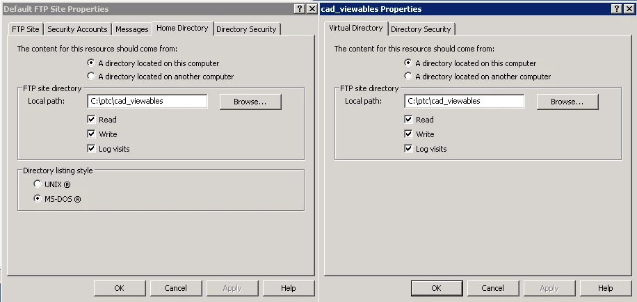

Mar 5, 2013 8:23 PM UTC
Ben,
I had a similar problem. The finale resolution was to create another directory level so that virtual directory & the agent.ini file pointed to different locations. PTC had suggested that the Default Home dir in FTP be different than the Virtual Dir. But I didn't find that was necessary.
In FTP I have:
[cid:image003.png@01CDDC6A.3BD129E0]
In the agent.ini ( I have:
Windchill Machine Path: = ftp:\cad_viewables\quality
C:\ptc\cad_viewables\quality
Also if you are running https: the user running the GSWorker service on the worker machine has to be a real user, not local admin. Which is a pain, because every time the password has to change, you have to go to the worker stop the service and change the password for the user running it.
