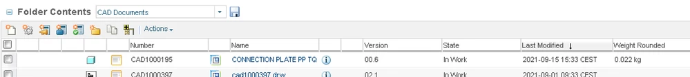

Calculated attirbute to convert floating point to 3 decimal places
Hello, maybe somene can help me, on our test environment we are pushing PRO_MP_MASS from Creo into Windchill with success but it come in as 15 character floating point notation, so a washer with a mass of 0.01 from Creo shows as 1.0 E-2
There are 2 objectives for this data, 1) export to excel to perform mass roll-ups, 2) Use it for Creo View colour coded searching of CAD mass against actual or predicted mass
For the 1st objective the floating point notation is OK becuase we can manipluate it in Excel, for the second objective it isnt possible to perform colour coded search in Creo View unless mass is shown as 3 decimal places.
So is it possible to create a calculated attribute which can convert the floating point attribute linked PRO_MP_MASS into a 3 decimal place result?
I know we can make a different parameter in Creo and use relations to push 3 decimal place value to Windchill, but this relies on having some automation to add the parameter when updating parts and there is a chance it found be deleted by the user.
If there are any suggestions to meet the 2 objectives I would be more than welcome to a new solution or even a different product.
Thanks!

@khimani_mohiki Thanks for your response. I figured out a way with a calculated attribute.
Let's say we have the Attribute WEIGHT synchronised from the PRO_MP_MASS
You can create a calculated attribute called e.g. WEIGHT_ROUNDED. The unit must be the same as on the WEIGHT attribute!
The formula for this attribute would be: execute("ch.bmr.core.businessfield.RoundNumberWithUnits",WEIGHT)

Unfortunately the calculated attribute can't be shown in the workspace. But on all other places (info page, tables) the value is being shown correctly.
We're hiding the original WEIGHT attribute and are only showing the calculated one.
Example of the WEIGHT and WEIGHT_ROUNDED attribute on the info page.
