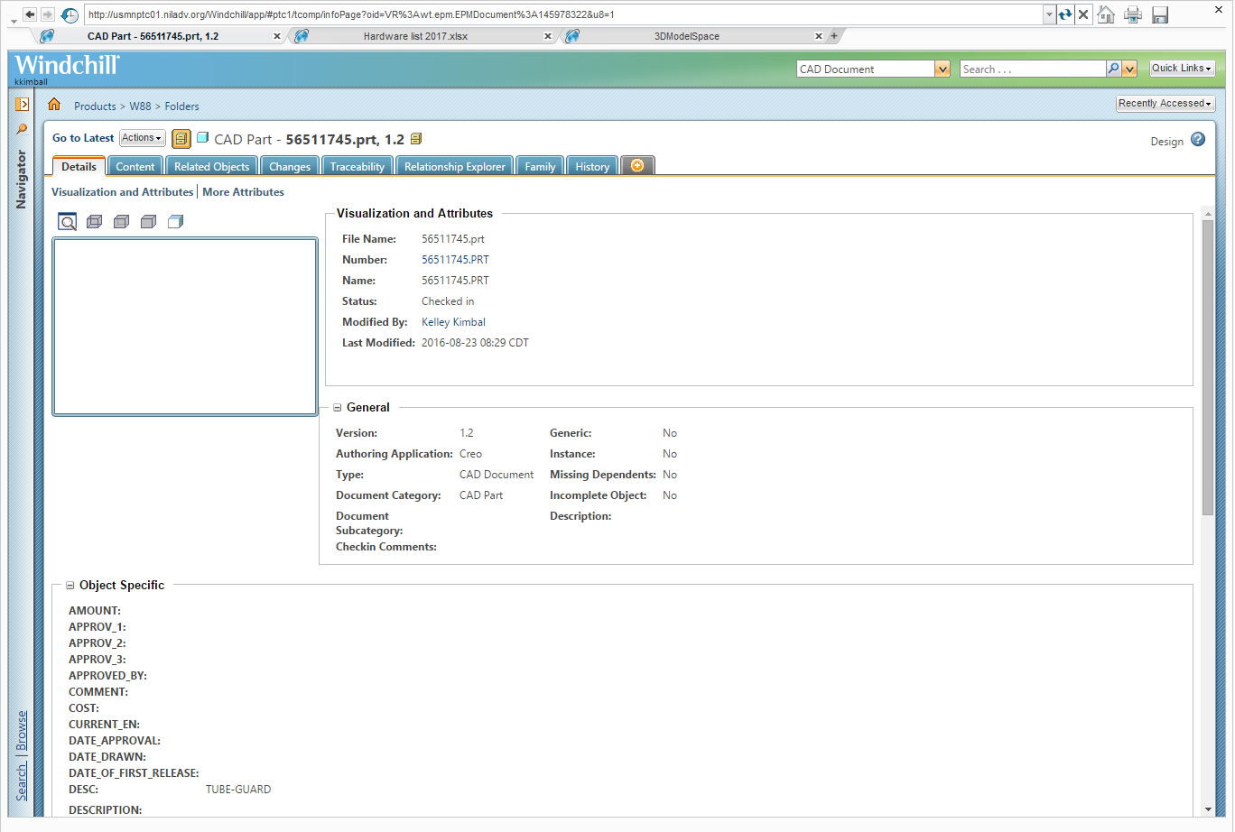

Can anyone tell me why in our Creo 3.0 M100 and Windchill PDMLink 10.1 M030 system setup I do not routinely see part and assembly graphics in the Windchill interface?
I occasionally will come across a file that will have a 3D model displayed that I can spin around, but it is very rare. There should be some graphics visualization for every file as far as I'm concerned. Any help to point me in the right direction would be appreciated.

Do your designers just do a Model Check-in or do they do a Model and Visualization Check-In?
Do you have thumbnail publishing enabled?

I don't even see an option for Model and Visualization Check-In, only Check In. Also, where would one check to see if thumbnail publishing was enabled?
Feb 24, 2017 7:56 PM UTC
From within Creo and a file open, highlight the file name in the navigator, right-mouse and in the drop down, select Check-In, then Custom, bottom option is Model and Visualization.

Check that the Creo Thumbnail Viewer is installed.
I recommend to disable Creo Parametric thumbnail when viewing CAD document's details page in the embedded browser from Windchill PDMLink
https://support.ptc.com/appserver/cs/view/solution.jsp?n=CS61508&
Lack performance with big assemblies
