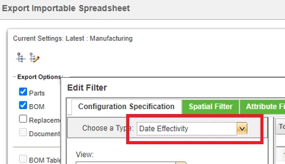

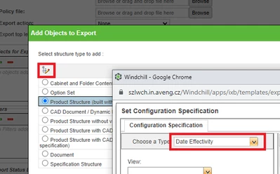

Hi @AP_10483126
If the UI does not allow you to do so, you can not export all effectivities from that UI.
you can just set export filter with effectivity
the functions export/export to spreadsheet contains a filter where you can set the effectivity,
so you can just export exactly one effectivity in one try...
