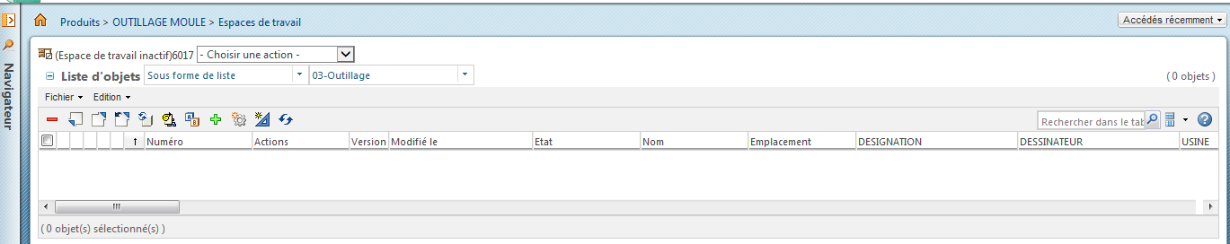

In Windchill PDMLink 10.1, in 2 different workspaces when I erase a folder (empty) , it re-appears when I re-login. Why ?

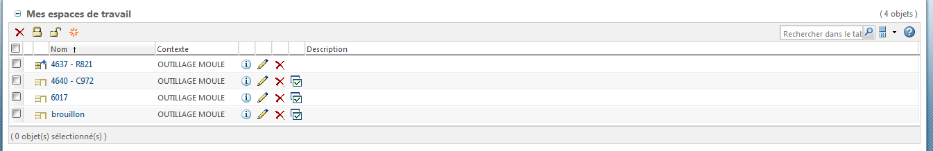

Attached to this post the screenshots.
The folder concerned is 6017.
Thanks.
Did

So you are trying to delete an empty workspace. Do you see any error in your event manager?

No error appears.
When I erase it in the workspace it's Ok but after a reconnect the folder re-appears.

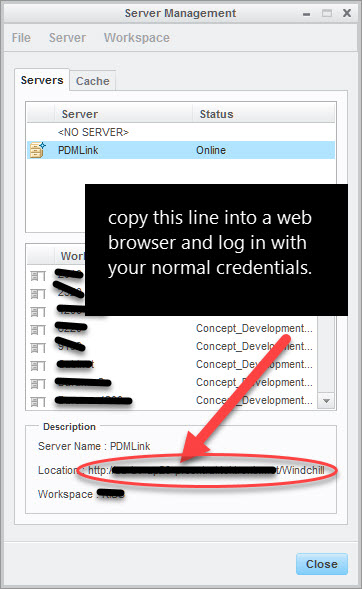

Your local data  may not be synced with your cloud data there may be a setting in your winchill options that is not in the proper setting..  Try using a web browser and login to the windchill server, do not do this from within Creo do this from just starting a web browser.   When you do then try and delete this folder.   To log into windchill from a web browser start creo then from the tab menus choose FILE then MANAGE SESSION then SERVER MANAGER.  You will see this dialog.  copy the line of text and put it into a web browser.  You will then need to log into your windchill server as normal.   Now you will see your basic workspace structure where you can then try and remove the workspace you do not want.
