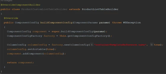

Hi @11025060
You can customize the com.ptc.windchill.enterprise.product.mvc.builders.ProductListTableBuilder class to add a column as you need.
You need to use a overwrite annotation "@OverrideComponentBuilder"
https://www.ptc.com/en/support/article/CS353007
PetrH
