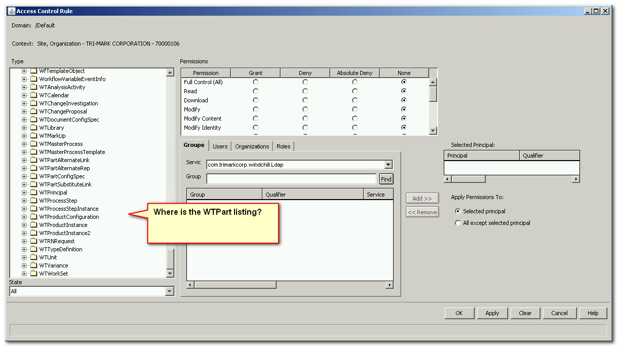

Hey there,
I am writing my very first Access Control Rule, and I want to create it for WTParts, but I don't see a listing for WTParts???   There is a DefaultWTPart item, but no WTPart.
Is it hidden? Different name? or something wrong with my system?
-marc

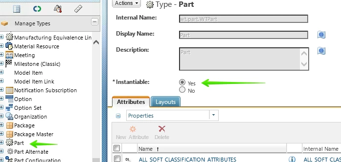

To create or modify ACL for any object type, Object type needs to be instantiable, see below link for more details and workarround.
https://support.ptc.com/appserver/cs/view/solution.jsp?n=CS33285&art_lang=en&posno=1&q=Instantiable%20ACL&source=search
Jul 30, 2015 8:18 PM UTC
Check if part is Instantiable in Type and Attribute Management.

Just checking but you are logged in as an Org admin?  It shows up on our system.
