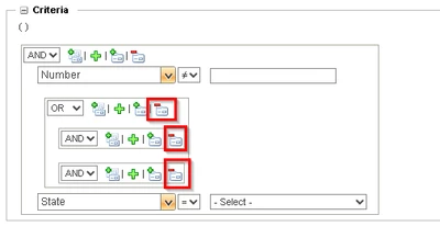

According the Windchill help center I should be able to remove nested attribute groups from a search, but the button does not register anything:
How can this be solved?

Hello @Alexander_Bgrd
Check if the behavior is reproducible in all browsers or just in specific one.
I would check a browser security configuration.
The browser can block javascripts from the page.
Add the windchill address to the trusted sites
check if some browser's addons can not case the behavior.

Is this in a standard browser window, or a Creo/WGM integrated browser? Some oddness with the Windchill UI if it is in the internal browser.
If it is not internal browser, does it happen in every browser type?
Aug 16, 2023 6:44 AM UTC
It happened yesterday in WWGM and in Microsoft Edge, however when trying again this morning there were no issues anymore and the attribute group was removed.
No idea what happened.

HI @Alexander_Bgrd
It could be a site/company IT security changes that could case it but IT correct it who know 😄
