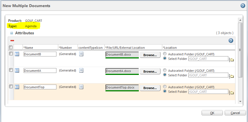

But, if you're specifically talking about using the drag-and-drop feature from the Folder Contents table:
  • If you want the drop-down Type menu to appear, that currently isn't possible - regardless of the preference settings. You can create a product idea for this (I did a quick search and it doesn't look like anyone has created one yet).
  • You can, however, use the Create and Edit > Document Create Default Type preference to change the type. For example, I set the preference value to WCTYPE|wt.doc.WTDocument|com.ptc.Agenda and then used the Folder Contents drag-and-drop action:
I tested this using Mozilla on a Windchill 10.2M030_CPS15 server -- so if the Document Create Default Type preference isn't working for you, it might be a bug that has since been fixed. (I wasn't clear on whether the preference wasn't working at all for you, or if you were just emphasizing that setting the preference to com.ptc.core.foundation.type.common.commonResource:SELECT_A_TYPE doesn't apply the Folder Contents drag-and-drop)
