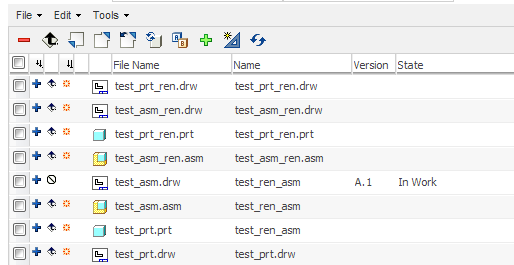

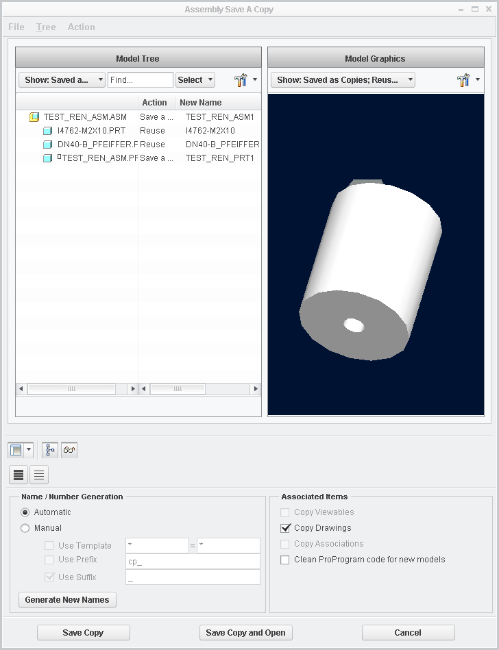

The *.asm/*.prt and their corresponding *.drw must have the same name. In the example I have created test_asm.asm and a drawing with the same name. Also I have created a part test_prt.prt and a drawing with the same name. Then I have # File #SaveAS #Save_a_Copy of the test_asm.asm to test_asm_ren.asm. In the "Save A Copy" dialog I also #Action #Save_a_Copy to the part. Creo copied the asm and the prt and their drawings to the new names. (In the following picture I added "1" to the names because I have taken it afterwards and it's just for illustration...)
