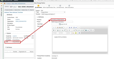

@HelesicPetr To make it work with Prod IBA mapping needs to changed to containerReference^wt.pdmlink.PDMLinkProduct~<ProdIba>
and the change notice OIR constraint for number need to be set to pre-generated :
On the CN create layout we will have the value otherwise with (assigned) we will get an error below
TTENTION: An object initialization rule could not be applied because an error was detected. Report this issue to your administrator.
 Rule argument 2 is null, please make sure the argument passed is not null, then try again.
Nested exception is: (wt.rule.ruleResource/387) wt.rule.algorithm.InvalidAlgorithmArgumentException: Rule argument 2 is null, please make sure the argument passed is not null, then try again. wt.rule.algorithm.InvalidAlgorithmArgumentException: ATTENTION: An object initialization rule could not be applied because an error was detected. Report this issue to your administrator.

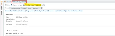

Create an alias attribute on CN type to get value from product
 I have made PRD_NAME with mapping  containerReference^wt.inf.container.WTContainer~name :
Use the attribute in OIR as below ;
Result :
