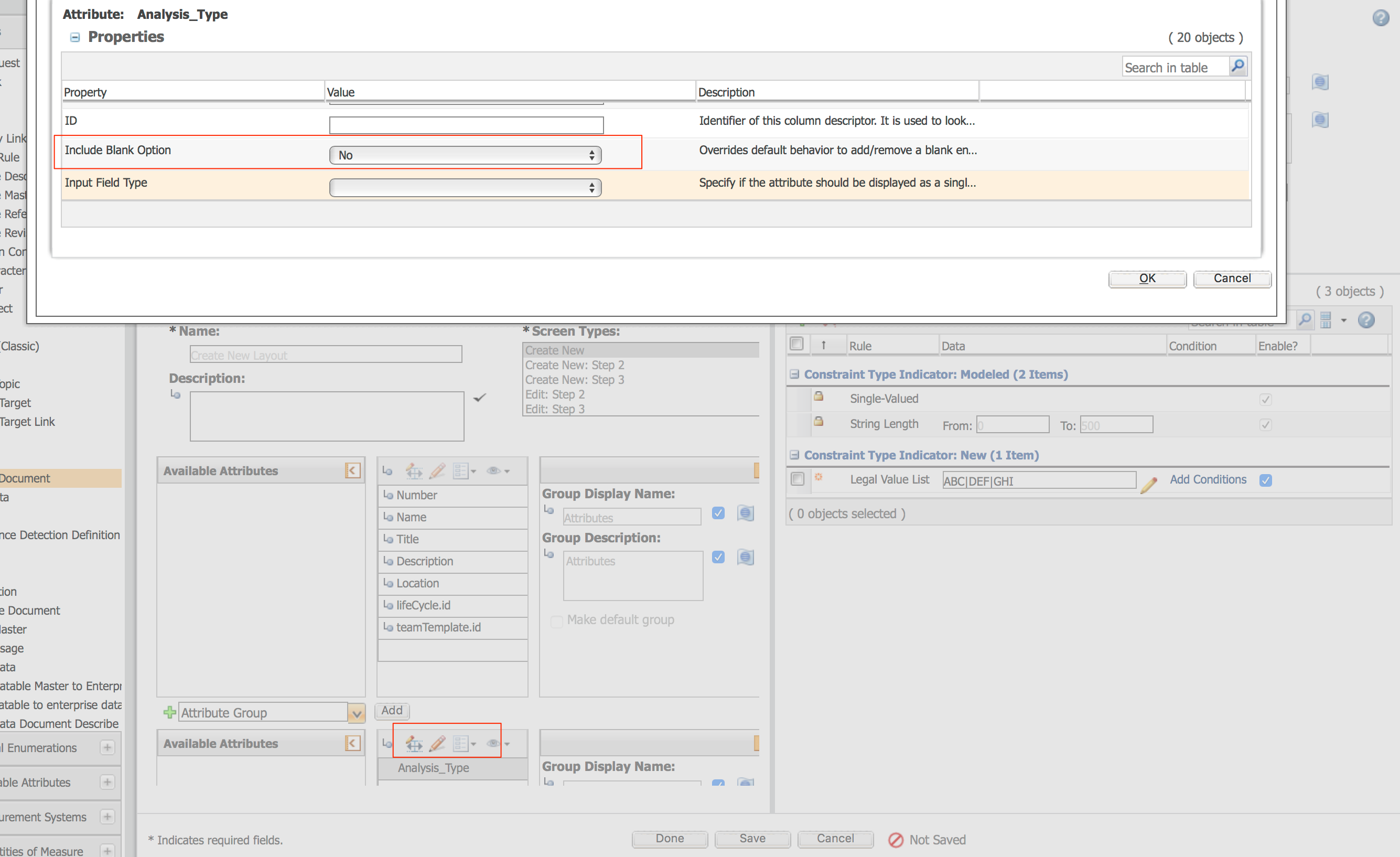

Refer to below screenshots.
1. Add a constraint , Legal value list - input all the values which you need as options. What you need is select is the edit icon - not add conditions.
2. To eliminate the blank value from the option, go to create new layout, select the attribute, click on edit.
3. This is what you see in create new document wizard

Apr 28, 2016 11:56 PM UTC
Regards
