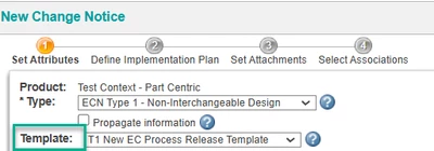

Can we get rid of Template on Create Change Notice layout?
Version: Windchill 12.1
Use Case: Can we get rid of Template on Create Change Notice layout? or at least make it read-only and default it to a particular template?
Description:

Hi @11025060
You can set the default template in the Change Template Administration
also you can disable others templates. Also you can set the templates for each change type.

@HelesicPetr is right then you get :
