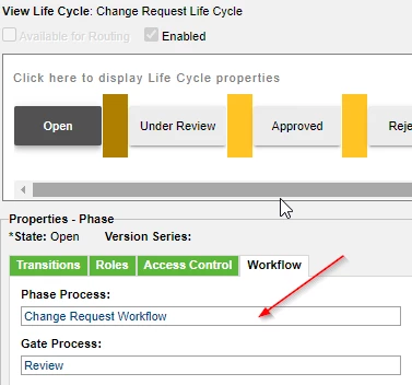

Can we make use of "CreateChangeRequestFormProcessor" which I assume to be OOTB to trigger a workflow?
I have an action that has no .jsp but this FormProcessor in the custom-actions. When the action is clicked, the change request UI shows up as wells a workflow is initiated. I'm just curious how.

From my knowledge, there is no OOTB feature able to do that.  Maybe the opening of the change request UI triggers an Event like PRE_STORE and then a custom listener in your system initiates this workflow. (https://www.ptc.com/en/support/article/CS214710)

So this processor I believe takes the input from the Change Request wizard and processes it to create a CR. When the CR is created, a lifecycle is assigned which has tied to its initial state, a workflow.
