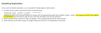

Can you tell me which admin UID and password this is referring to and which file will contain it ?

hi @PD_10631511
It refers to the site admin. so if you use default admin account it is "wcadmin" and password that has been chosen during installation process.
For developing system it is also wcadmin but for production/test environment password should be more complex.

Are you sure about this? I would presume that any admin related to Windchill DS would be cn=manager (default installation). This is at least the case given in this article: https://www.ptc.com/en/support/article/CS355531
PS: I have not tried this first hand and only rely on the article.

Yes you right, I am wrong. My bad.
The steps do not mention that it should be DS admin. It is mention only in the first row of the help center.
I overviewed that.
Definitely the Directory Admin should be used.
adminUID=cn=Manager

it should be cn=Manager and its password , the credential used to start DS
