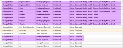

Can you validate in the Policy Administration by looking at the "View Access Control Lists" tool. Do both roles exactly match?  Are you seeing actions missing or greyed out for the role that is denied access? screen shots?
Aug 15, 2025 12:30 PM UTC
@avillanueva Here are the ACLs.  We use a custom interface for creating CNs.  Design Engineer can but Packaging Engineer cannot.
