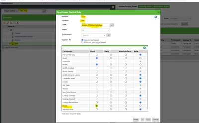

cannot delete representation
I am using Windchill PDMLink Release 12.1 and Datecode with CPS 12.1.2.8
users cannot delete Derived Image.
Methode Serveur error
2024-06-19 11:19:42,706 ERROR [ajp-nio-127.0.0.1-8010-exec-6] wt.access.evaluation.report aros - "aros" does not have Delete permission for "EPMDoc Config Spec - wt.epm.EPMDocConfigSpec:96272141" in Administrative Domain "Site /User".
2024-06-19 11:19:42,722 ERROR [ajp-nio-127.0.0.1-8010-exec-6] wt.wvs.publish.RepHelper aros - Unexpected exception (wt.access.accessResource/19) wt.access.NotAuthorizedException: ATTENTION: Secured Action. You do not have the necessary authorization for this operation. Contact your administrator if you believe you have received this message in error.
Here are the errors that I faced
user cannot delete representation. he has delete acces on derived image in the policies
Thank you for your help

    try to add the missing  delete permission in Domain "Site /User":

    The error points epmdoc config spec object. It’s a different object. Different acl
