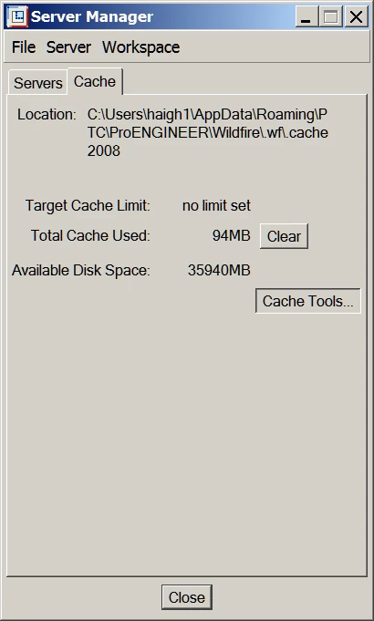

One thing to watch out for, when it comes to cache size, is that you do not limit the size of the local cache.
Years ago when PTC came in to help us migrate from Intralink to PDMLink 8, the guy had us put this in the config.pro
dm_cache_limit 4000
That limits the local cache to 4gb in size.
That might sound reasonable. But the problem is when the user bumps up against that limit. It can cause ProE to become non-responsive, and will likely corrupt the cache. A couple years ago I started getting a number of users having cache problems. I ultimately traced it down to this config restriction on the size of the cache.
Better to set it to 0, and let the cache grow to any size and dealing with any large cache issues by clearing the cache using the cache tools.
