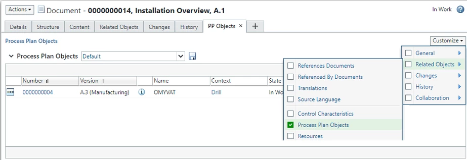

Cannot see Operation linked to Document (described by or referenced by) from the HTLM Related tab of the document.
Should that one can see in the document links (Described by and Referenced by) he enters the document and objects MPMLink (MPMOperation and MPMProcessPlan).

This functionality is not part of Windchill that could be easily shown.
There are few ways how to find the related operations.
For example Relation explorer could show this link between operation and document or.
From the detail info of document is possible by action activate Display related manufacturing objects and there use Advancedcollector

1. Currently Windchill 11.0 Requires you to:
Actions/Display Related Manufacturing Objects
While this will get you information it is not easy to teach users when they are already used to related tab for wtPart Relationships.
I think the Request is if a Document is Related to a Process Plan  or if a Document is Related to a Process Plan they should have their own section on the Related Tab under a Document.
Ease of Use for the Users is to have One Location (Related Tab) for Objects Parts, Other Documents, Operations and Process Plans.

Absolutely agree.
Customization is required if customer needs to show that information easily.
Customization is faster then wait for PTC long way Idea workflow.

This problem has been addressed in Windchill 13.0.X. A custom table can be added to a new tab on the Document details page.
The table displays related operations, process plans, etc.
