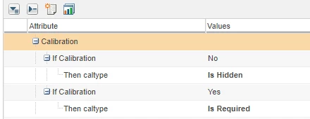

I've set up two attributes, a boolean "Calibration' and a string "Calibration Type". The default value for "Calibration" is "No".
In the cascading attributes section, I have two rules. If calibration is no, hide calibration type. If calibration is yes, calibration type is required. (There is no "unhide" option).
In the edit page, this works, mostly. If the existing part is without the calibration attribute, it gets set to 'No" and no cal options are display. If I then change from no to yes, the edit page refreshes, and the cal type options appear.
BUT, if the existing part already has calibration set to yes, the initial load of the edit page shows 'Calibration YES" but the cal type is still hidden. Cal type doesn't appear unless the Calibration boolean is changed.
Part has existing "Yes" selected on Calibration Attribute shows:
When it should show:
Cascading attributes config:
I must be missing something.

Jul 12, 2024 3:42 PM UTC
Does it make any difference if you re-order the rules?
Another issue I found is if a calibration type has been picked the value stays set when calibration is set to No.

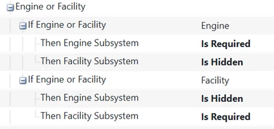

If I have a cascading attribute set like this:

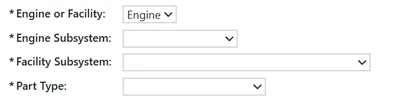

And set a default value of, say, Engine - I'd expect that the default view in the part layout would show the facility subsystem attribute hidden.
Instead, both fields show:
The correct cascading effect only works when I click any other option within the first attribute and then reselect Engine.
