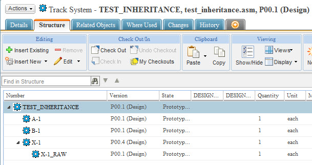

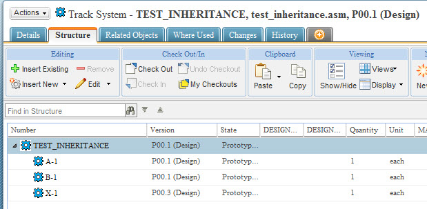

Here is the default WTPART structure generated from the CAD structure
PS: Within that example the X-1 is a PART link with a CAD-DOCUMENT that have a merge inheritance!! At first I would appreciate to be able to see that Merge reference by default in the PART structure:
So basically to incorporate the RAW we just insert the raw under the X-1
Af first this seem to work but when the Procurement extract the (Component list report) from windchill the report ignore the MACHINE PART?
So the only alternative we have so far is to insert the RAW model at the same level as the MACHINE PART. But this mean that we have to insert the raw manually each time we use the MACHINING PART...

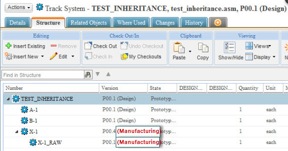

if you have MPMLink (or by using the basic "new view" function without MPMLink), You should change the view of X-1 part from "Design" to "Manufacturing", and then add the X-1_RAW (may be also created in "Manufacturing" view). And then use the OOTB BOM filter criteria to browse the eBOM or mBOM.
But adding your raw material under the finished part , even if you use MPMLink, and whatever is your CAD methodology, will be a manual step.
Because more depending of your manufacturing or part stocking strategy .... (can have more levels of raw material depending of process plan, alternate BOM for different manufacturing option, etc ...)
(may be can be customized to be automaticly done when changing to "manufacturing" the view of X-1 part if CAD methodology rules are systemic)
