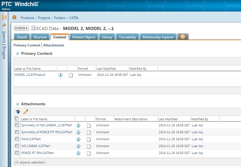

I tried to upload a catia file as u can see in the screen shot below. This is my question.
1. Why the file formats become unknown?
2. If I check out the primary content, the attachment would also be checkout?
3. I try to download but I cannot open it because it becomes uknown format.
Thanks!

Hi
you try to use a "classic" Document to store a Catia file. Catia V5 mime type is not defined in Windchill. So file type is unknown.
you can load new Document mime type in Windchill.
Or best solution, use WorkgroupManager for Catia V5 for a real CAD PLM integration

Hi!
Thank you for response. how to load mime type in windchill?
thanks!
GregoryPERASSO
November 27, 2014
should be something like wt.load.LoadFromFile with a xml file in param
should be documented in Windchill documentation Install guide or admin guid
and some example in Windchill install directory
\Windchill\loadFiles\dataformats.xml
