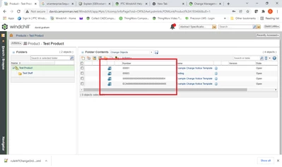

In the image below the you can see four Change Notices.
The first two where created using OOTB OIR
The third was created with OIR sequence generator set to 32
The fourth was created with OIR sequence generator set to 29 as it included a three character prefix, ECN.
If you experiment with the OIR and set the prefix and/or the sequence generator such that the number's length would be greater than 32 an error window will appear when you try to create the Change Notice.
Does this answer you concern?

@STEVEG ,
OOTB the limit for the number of characters for a Change Notice number is 32.
If you check in the dB where the number is stored it's clear that 32 is the limit.
David
