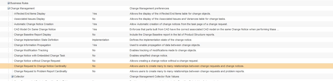

Oct 15, 2019 7:49 PM UTC
Here are the preferences relating to Change Management that SteveG was mentioning.  You can tailor them, to allow for many to many, but I'm not sure that is what Paul is looking for...sounds like he's good with the out of the box preferences instead.  But anyway, these prefs will allow you some tailoring of this.
