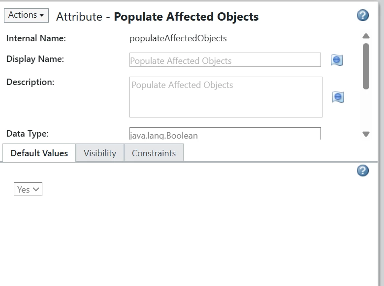

Hi ​@ASP_000000001,
Are you using a Change Object Template to Create Change Notice?
If so, set Populate Affected Objects to Yes in the Change Task of the Change Template.
Sep 11, 2026 9:19 AM UTC
Not using any templates. The default value is set. Still it does not populate. Is there any preference ?
