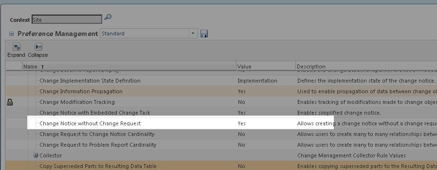

OOTB change Notice can be created only from Change Request.
you can change below preference and check if it works for you.cnwithoutCR.jpg

Thanks Shreyas
