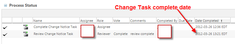

Does anyone know what needs to be added to a report to get the Date Completed of a change notice or a change task?

I have used that.  However, what I'm looking for is the date that each person with the Task of the CN or the CN itself completed it.

I found the name of the completed date of the Task but I also want the completed date of the CN.
Dec 9, 2015 2:40 PM UTC
We use completed date from "Process Status" table under "Process" tab of Change Object.

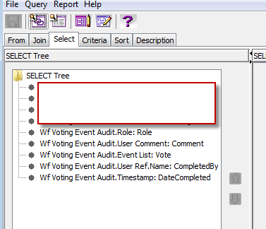

For Reporting, its available under WF Voting Event Audit table.

I need to find the Completed Date of the Change Notice.  Not the Change Task.  I already found that wf voting event audit.
I don't think I have the right Join's.

I got it.
I looked at the joins.  I had the Work Item referencing the Change Task.  I changed it to have the Work Item reference the Change Notice and it showed the time I was looking for.
                       Wrong (for what I wanted)                                                   Corrected
