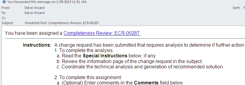

Hi guys, here is the code I’ve used. It includes the prefix check (I may have my nomenclature backwards) to ensure it doesn’t duplicate the loop. Note this code adds the activity number to the end of the task.
If you enter this code into the “Start” transition of an ECR task it will append the Number of the ECR to the Activity name and subsequent email notifications and of course the tasks themselves. It must be tailored slightly to fit other workflow objects such as ECN’s or Problem reports. See examples below:
CODE:
// This code snippet is object specific and gets the number of the object and assigns it to the string number
java.lang.String number = ((wt.change2.WTChangeRequest2)primaryBusinessObject).getNumber();
// You can use the following instead of the line above for other objects
//= ((wt.change2.WTChangeRequest2)primaryBusinessObject).getNumber();
// = ((wt.change2.WTChangeOrder2)primaryBusinessObject).getNumber();
// = ((wt.change2.WTChangeActivity2)primaryBusinessObject).getNumber();
// =((wt.change2.WTVariance)primaryBusinessObject).getNumber();
// =((wt.change2.WTChangeIssue)primaryBusinessObject).getNumber();
wt.workflow.engine.WfActivity myActivity =(wt.workflow.engine.WfActivity)self.getObject();
String prefix=myActivity.getName();
if (!prefix.endsWith(number)) {
java.lang.String Activity_Name = prefix + ": " + number;
myActivity.setName (Activity_Name);
myActivity = (wt.workflow.engine.WfActivity) wt.fc.PersistenceHelper.manager.save(myActivity);
NOTIFICATION EMAIL:
[cid:image001.png@01CDFE17.241F33E0]
