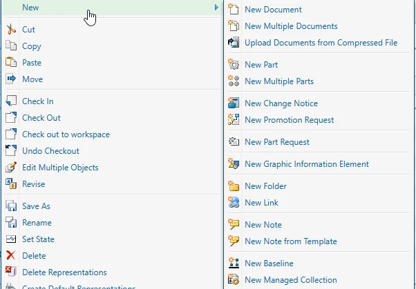

Change Request and Problem Report missing from Actions dropdown
I have a brand new install of PDMLink 13 and noticed in my testing that both Change Request and Problem Report are missing from actions. I am still in the middle of configuring things so I have applied my customizations from 12 and brought in my lifecycles, workflows and OIRs. I do see Change Notice and Promotion Request. Scratching head here but I am sure its something simple.

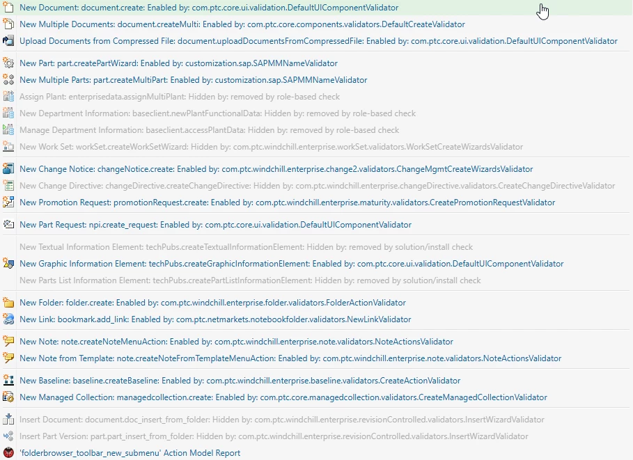

I do have some additional actions like Delete Representations that I added in. I checked the licenses and the user I am testing does have Windchill Advanced license among others. What's weird is that if I look at jcaDebug, its not even greyed out.

Could you please verify if the actionmodel namded folderbrowser_toolbar_new_submenu is in Windchill/codebase/config/actions/custom-actionModels.xml?
If there is, please compare the actionModel definition with OOTB one which is defined in Windchill/codebase/config/actions/FolderManagement-actionModels.xml.
The following two actions should be in the model with name folderbrowser_toolbar_new_submenu, like below:
<model name="folderbrowser_toolbar_new_submenu" resourceBundle="com.ptc.windchill.enterprise.folder.FolderActionResource">
<action name="create" type="changeRequest" shortcut="true"/>
<!-- New Change Request -->
<action name="create" type="problemReport"/>
<!-- New Problem Report -->
</model>

"It's me, hi, I'm the problem, it's me". Yep, I sure its something I did. I am checking my custom action model files which I tried cleaning up but may have introduced a bug.
actionmodels.xml file is missing an entry called action search table toolbar. Please add the model and restart the server.
I saw this message on screen when digging into jcaDebug so yep, @Maggie_Ma , you are on the right track.
