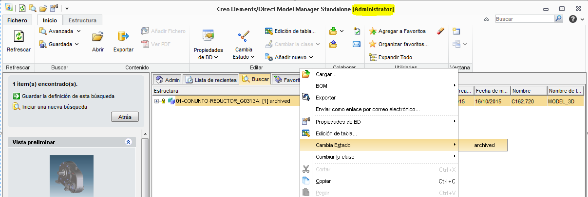

Is there a way I can change the state Archived to work? I´ve made a mistake clicking "archived" while I was changing the state of an assembly from released to work and now I don´t know how to change it again.

A "normal" user can only change states based on what is allowed in the lifecycle.  An administrator can go from any state to any other state without restriction.  Talk to your admin.

Thanks for your answer. The problem is that i'm the administrator and the only option I can choose is "archived" again, look at the photo. I don't know if I have to enable some aplication or additional permissions.

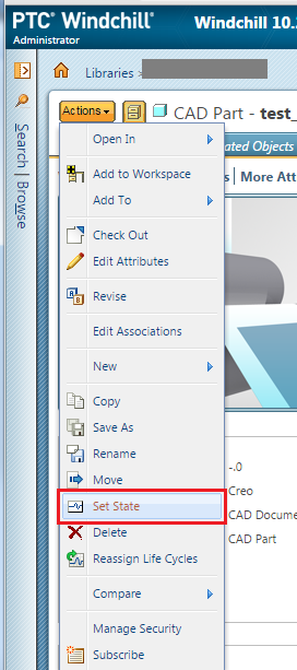

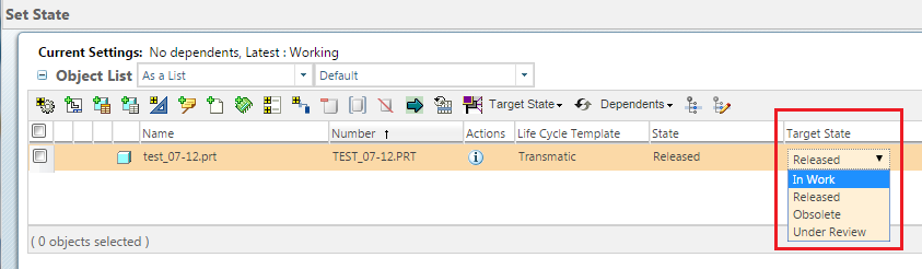

I am not familiar with "Creo Elements/Direct Model Manager Standalone".  What do you see if you log into Windchill directly, view this object, and perform set state from there?
