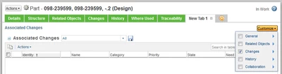

We've upgraded our Windcill 11.1 server to 12.0.2.2, after upgrading we notice that the Change tab which was present in the object information page is missing and we try to create a new one but in the customize option itself it is not available.
I've attached the screenshot FYR...
Mar 3, 2022 4:37 AM UTC
Hi Tom,
The issue got fixed, we've some customization in the Change Management actions and we use the old action.xml file but in 12.0.2.0  PTC have modified the OOTB action xml that a reason for this issue, now it's fine.
