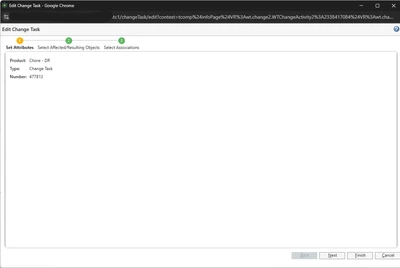

I am facing a problem where the attributes on the first step of the edit change task wizard are not displayed.
This is at wcadmin all the way down to a user with technically the correct access.  I have sifted through all the ptc CS and nothing has fixed my issue.  I can update resulting objects and finish the wizard just fine.  This is on a customized system with little documentation.  13.0.2.0

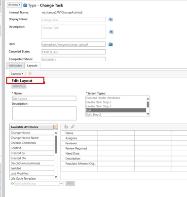

Can you double check the edit layout is set correctly :
Buiꓘa

Any errors in logs when this happens ?
Buiꓘa
6-Contributor
Jul 29, 2025 4:28 PM UTC
Nothing that sticks out.
Buiꓘa

Do you use a Profiles? Someone can add you to a profile where attributes can be hidden from the user.
Also check the edit layout settings in the Type and Attribute Management.
PS> if you say customized system what does it mean?
PetrH
6-Contributor
Aug 7, 2025 12:27 PM UTC
They had edited the jsp pages and we dont have any documentation of what was done.
HelesicPetr
Aug 7, 2025 12:30 PM UTC
Hi @Wayne.Beck.Gen
That is a very bad situation.
If you do not know how the jsp page has been modified then it is really hard to find root case,
A sharing the jsp pages could help to identify the issue, but I could understand it is not possible
