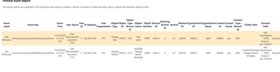

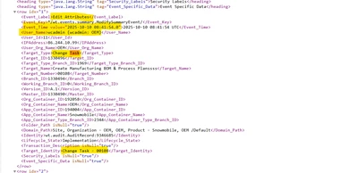

23-Emerald II
Oct 10, 2025 12:59 PM UTC
+ preview screenshot
