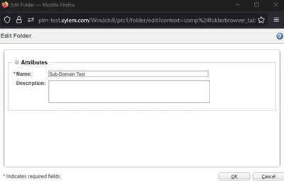

Is it still possible in Windchill 12.0 to change the domain of a folder? When I edit a folder (by right clicking it -> Edit) I don't see the 'Domain' attribute. I'm logged in as a site administrator (but not the default wcadmin if that matters). Or maybe there's some preference/property required?
Here's how the Edit page looks like for me:
Best answer by FS_9776388
Yes, it's still possible in Windchill 12 and I figured out the solution: In Preference Management utility change 'Security -> Display Folder Domains' to Yes
I've learned that from this PTC article: https://www.ptc.com/en/support/article/CS19998
FS_977638810-MarbleAuthorAnswer
October 22, 2025
