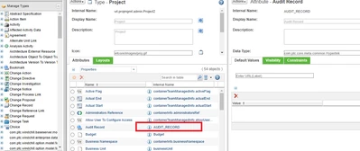

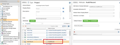

The internal name of an attribute can be changed with a simple database edit.
In the example below the original internal name, AuditRecord, has been changed to AUDIT_RECORD
NOTE: Windchill restart after the database edit is required to take affect.
Before
After
