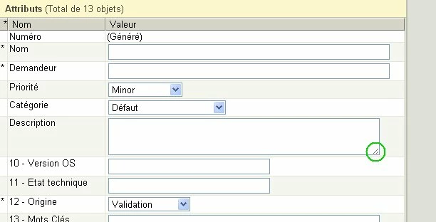

Same here. Interestingly enough google chrome will let you resize the window. It also provides a handle in the lower right corner of fields which are dispalayed with a scrollbar by the other browsers. for instance the description field of a new PR (see picture).
It seems to work only with input boxes though.
