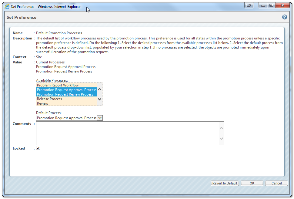

Hey, I was wondering if anyone has experience in changing the Windchill preference "Default Promotion Processes" by adding more processes?  One of the processes listed is Notification, which is exactly what I want it to do.  I think the process is from ProjectLink, there is a Notification Routing that can be used there.
Any downsides or limitations?  Best Practices?
See screenshot for details.

We have used this quite a lot, Provided the workflow is written so that it is not expecting a primary business object type of a specific class then it should be ok.
You can also restrict the workflows available based on the state transitions if that is of use.

For us it is common practice to use and configure this.
