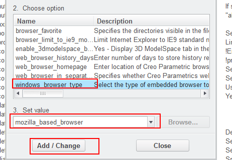

Has anyone experienced issues with selecting the check boxes while using Windchill?
We are seeing common yet sporadic reports where the Windchill user cannot place a Check mark in a box for objects list in a WorkSpace or in the Cabinets location. The workaround so far is to Refresh the page then the functionality usually works, but may return at any time. This occurs in the Embedded browser and with a standalone Internet Explorer 11 browser.
Shown is an example.
We are using Windchill 10.2 M030 and Creo 3.0 M050
Thank you for reviewing this question.
Feb 4, 2016 12:25 PM UTC
Yes, we are having the same problem. The only resolution I know of is first time it happens, press F5 - then it dosn't happen Again in the session.
Mar 29, 2016 6:54 AM UTC
Hello Larry
This might be the comparability issue between Windows browser and the windchill
Just try the windows Browser type to Mozilla_based_browser . in congig.pro and see how it goes
Regards
