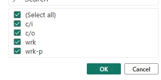

Use Case: I need to extract the check-in and check-out details of parts from Windchill data base. I located the table (EPM Document) and the column (State Checkout info) which has below values: 1. C/i 2. C/o 3. Wrk 4. Wrk-P I assume C/I & C/O mean check in and check out respectively. But what do WRK & WRK_P mean? Please advise.

I believe those are work in progress or work in progress private respectively.  They should represent local workspace copies that might be modified and uploaded but not checked in. Your settings can allow users to make copies without checking things out but they only exist in their workspace privately to them. Or it could represent stuff that has never been checked in.
