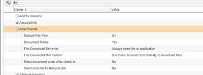

Lots of questions here. You have your understanding of the process right. Check your preferences since it looks like you download option is set to Windchill Desktop Explorer. That you need to have installed to process the wcdti files. It also provides direct check out/in from Office apps. If you want you can use basic browser which would just put the file in your downloads folder.  Your preferences are located in Quick Links, My Settings - Preferences.
See file download behavior.
Checkout and Edit assumes you have the edited files ready to go to upload.
Check out and download would give you the file for edit. Then when done, edit or check in should allow you to upload the new file. Hope this helps.
