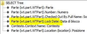

I have a couple of reports that I use every day to check if some user leaves WTPart or WTDocs in check-out.
I think I have started from this query builder https://support.ptc.com/appserver/cs/view/case_solution.jsp?n=CS35948&lang=en
For the part you can use this to have lock date:

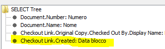

For WTDocument you can use this:

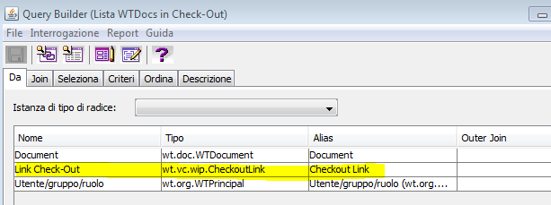

Marco,
That's odd.  I don't have the Link Check-Out entry.  What version and build of PDMLink do you have?  i have just a Checkout Link so I'm assuming that's it?
MarcoTosin
Mar 21, 2016 11:59 AM UTC
We have 10.2 M030.
I have also noticed that sometimes name of types are different between query builder I collect from TS or other place and types I find in my system.
We use Italian as our browser language and sometimes I have to change it to US to find the right types.
