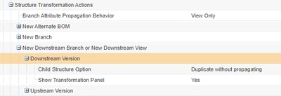

I am not sure on 11.2. But, on my 12.1.2 environment, there are preferences to set the default values. You can check and navigate to Associativity > Structure Transformation Actions > [Action] > [Upstream/Downstream] Version > Child Structure Option  under Preference Management. Sharing a screen grab for reference.
Hope this helps.

Great for your solution. In Windchill 11.2 it works as well.
