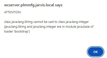

Class java.lang.string cannot be cast to class java.lang.integer when using a Reference Doc Template
Version: Windchill 12.1
Use Case: I have created a Reference Document Template using an Excel Document.
Description:
When trying to create the first Reference Document using the new Template I get the attached error.  Not sure which field is creating this issue?

Hi @IanW
The method server logs could help you to identify the root case.
The error just say. that you put string value in the integer type so it is not compatible
If your excel file contains some columns that are linked to the Windchill attribute, then be sure to use correct excel type column.

I help Ian with this post.
You would not believe what I found.
The TemplatesUtilitly.changeFilename() method was failing while trying to get the filename truncation length from the preferences.
The line that failed is below.
Integer var14 = (Integer) PreferenceHelper.service.getValue("/com/ptc/windchill/enterprise/templates/doc/filenameTrunctionLength", "WINDCHILL", var13, var12);
The PreferenceHelper.service.getValue() method return an Object which happens to be a String in this case.  I did confirm this. And it is deprecated.
So, I hacked the class and changed it to a non-deprecated method to get the object and then create the Integer object.
Object obj = PreferenceHelper.service.getValue(var13.getContainerReference(), "/com/ptc/windchill/enterprise/templates/doc/filenameTrunctionLength", "WINDCHILL", var12);
Integer var14 = Integer.valueOf(obj.toString());
The hack works great.
I have passed this on to TS.
Curious to see what they come back with.
FYI, the PreferenceHelper.service.getValue() method is deprecated.  Not surprised by this.  I see this all the time with OOTB code.
