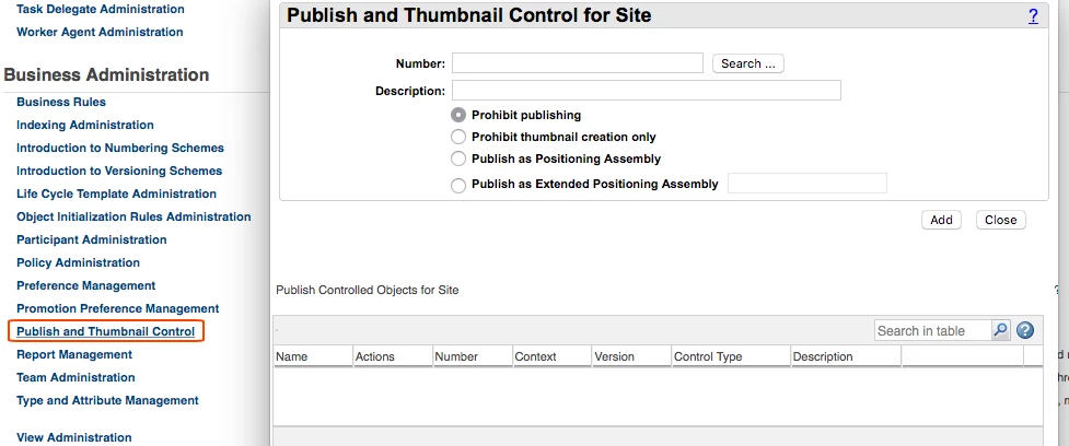

Hi all,
We have 3 epmdocuments that are prohibited for publising by accident. How can I clear this "filter" on these epmdocuments? Google didn't find the awnser for me.
Thanks in advance
Feb 7, 2018 10:28 AM UTC
Site--> Utitlities
or
Org --> Utilities
Site--> Utitlities
or
Org --> Utilities
Feb 7, 2018 10:30 AM UTC
Hi brueegg,
Thanks for the quick response and thanks for the solution!
