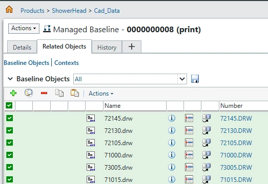

Collect all Drawings related to assembly and add to clipboard?
I have a great process for mass-printing or creating PDF’s from Creo View.  One of the key steps is collecting all the objects in Windchill and adding them to the clipboard.
Does anyone know a way I can select an assembly, collect all the drawings of the assembly components and add them to the clipboard?  Anywhere I can get to that has the collection rules doesn’t seem to have Copy and anywhere that has Copy doesn’t seem to have a collector.
Thanks in advance!

Great question.  I am looking to get the drawings related to all the components of the assembly including the assembly itself.  I then want to add them to the clipboard so I can easily open them in Creo View.

there are a few ways to do this off the top off the top of my head.
  1. use the advanced picker and add the assembly to a workspace, then filter on drawings and copy to clipboard.
  2. create a baseline and use the advanced picker in a similar method.
  3. create a package (but that's probably overkill)

​@BryanK  & ​@avillanueva I tried option 1 before even posting here but I quickly noticed I could add individual items to the clipboard but once I multiselected, the option was gone from the RMB Menu.  Am I missing something?
BHurler
BHurler11-GarnetAuthor
11-Garnet
Apr 30, 2026 3:24 PM UTC
​@BryanK & ​@avillanueva I Tried Option 1 before even posting here; however, I noticed that I could only Copy from the RMB Menu when I selected a single object.  When multi-selecting, Copy was oddly missing.  Any tips on not picking objects and adding them one by one?
Apr 30, 2026 10:37 PM UTC
hmm, ok. then a different method.
  1. open the top level wtpart structure
  2. expand all levels required.
  3. show all (cad and drawings)
  4. Select all and copy.
  5. open clipboard and filter on prt / asm
    1. remove prt / asm
  6. you will be left with drawings
if you are not using wtparts then a baseline is the way to go.
