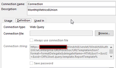

Sep 9, 2022 5:35 PM UTC
Its possible to pull the report into Excel via and have it pull down data by refreshing. Its how I do all my complex metrics reporting. I pull 4 reports and combine. Does Power BI have the ability to pull data from a web query?

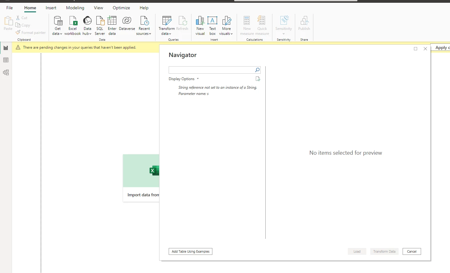

Feb 19, 2024 11:44 AM UTC
Hi ,
I am tried this same it is working fine without SSO system, If SSO enabled system the URL is not working. the below error message is occurred. Any thing need to be provide some details?
 Can you help on to resolve this.?
HelesicPetr
Feb 20, 2024 10:30 AM UTC
Hi @SARAN
You need to solve the issue with your SSO system provider.
