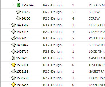

We have color coded parts and document types in Windchill. This is a way to show access right responsibility in a very user friendly manner. It is very easy to do, but it is not used widely for some reason. You only change the picture icon in the part (or document) definition. The picture below shows different types of parts in a structure at the structure tab. This will enhance the rolls, in my case, the project. Electronic engineers owns the green onces and Mechanics the gray. Yellow is own by a third party. If the structure is to be released, and that parts are not good enough, we can easy see how is behind schedule.
Is there any more possibilities like this that I have missed out on?
PTC: Why is the icon stated above not used in the Workspace. My green electrical parts turns gray when part is downloaded... annoying.

You can change the icon for each (sub)type in the Type and Attribute Management.   Icons need to be stored on the Windchill server.
Problem of displaying previous Icons in Wokspace is a cache issue.

Just the one you missed out is the ones in RED which should be the ones "Checked-Out", irrespective of who-so-ever owns it. That way, it can be known easily by anybody who is about to release the assembly / product / end-item, that this is not going to fly.

Hi Sven. If it were a cache issue, how would you resolve it? I don't think it is...
Jan 19, 2016 10:42 AM UTC
We had a similar issue with the customized icons; old icons were shown in advanced search.  I thought we solved it by restarting Windchill and deleting Apache Tomcat cache.
