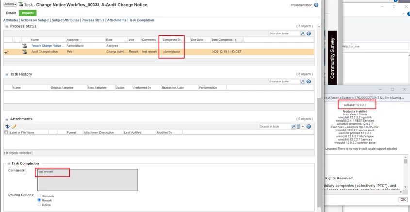

Hi @LG_10096154
I don't have any issue to complete the task as an admin for someone else.
Version 12.0.2.7
In your case there can be some ACL troubles on the context level.
Or this feature has been applied in later CPS 08-15
PS: what date/time have you realized this behavior ? After update? Upgrade? any other changes?

@LG_10096154
So your developer has changed the behavior, not PTC.  That explains a lot.
