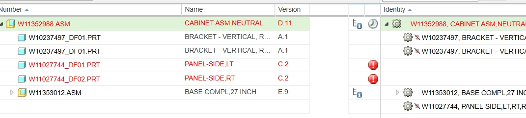

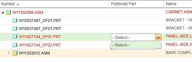

Use Case: Compare to part structure doesn't show any part to resolve
Description:
i have an assembly where the build is out of date. when i tried to perfom build action, i saw there are CADs which doesn't have corresponding WTpart. see attached image.
the .PRTs in red are having Image association with a common WTpart. is that an issue here ?
thanks
sandy

hi @BrianToussaint
thank you for reply. i saw the parts were in released state, after revision i could able to resolve the parts. but as per PTC article Image association doesn't contribute in structure so how build got successfull?🤔
anyways thanks again.

Hello @Sandy7
Here is an article explaining the associations.  You need to have an owner link.  Explanation of CAD to wtPart links
