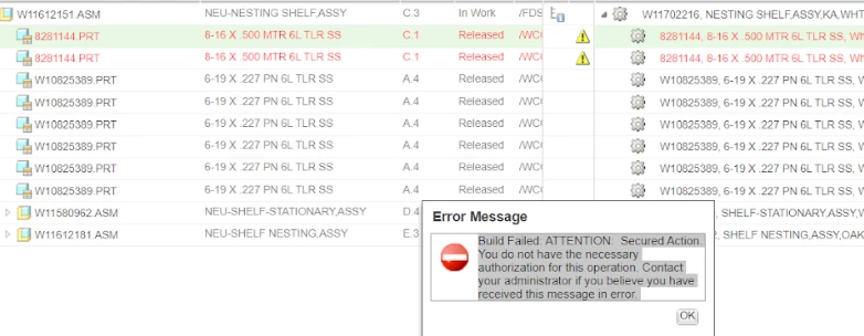

compare to part structure showing never build problem
When i do compare to part structure to an assembly, i see there are some CAD and part with warning saying that they were never build.
when i try to build them up, it is showing an error. see attachment.
could you please help on this?
Br,
sandy

I think you were trying to build a "Released" part. (Pls note build will create an iteration of the WTPart , which inturn requires it to be in a non-locked state , "Released" is generally a non-editable state (Locked) for a regular user.

issue is with lack of permission can you enable logger wt.access.evaluation.report to Debug and share the logs ?

You need edit access to the WTParts. Make sure they are not checked out, in an editable state, and that you have edit access to the Context where they are stored.

Hi Hari,
You are right, the admin said the same. he helped me to resolve them. thanks...!
